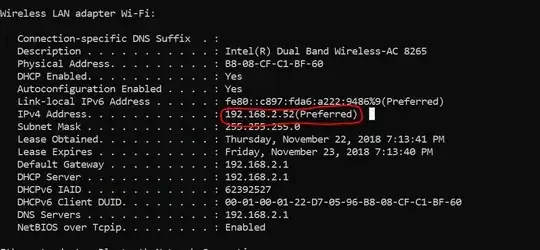

So I got the connection timed out error (error 110)
This is the IP address I got from ipconfig /all: IP address in red circle

Both of the devices are connected to the same network, but I have been tinkering around for the last couple of hours but still failed to get a connection between the 2.
Any idea? Seems like a pretty basic snippet of code. Thanks!

Since your server seems to be windows-based, you're likely being bitten by the firewall. Disable it, or make an exception for port 5005.
Alternatively, try running the server snipped on the RPi and the client snippet on the computer, and see how that goes.
