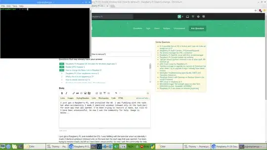

I just got a Raspberry Pi, and installed the OS. I was fiddling with the task-bar when accidentally I made 2 identical windows (showed only on the task-bar) for each app that was opened. I've been trying to restore it back, but till no I have been unsuccessful. So now I ask the community for help. Image is below... Look at the task-bar...
Please help me... Thank you in advance.
You have to remove one of the Task Bar applet from Panel, do the following steps:
  • Right click on the clock or start button on Panel (the task bar)
  • Click Add/Remove Panel Items. Panel preference window will open
  • Click on Panel Applets tab
  • There will be two entries of Task Bar (Windwo List) untick second Task Bar (Window List) which will be listed after Ejecter applet as seen from the screenshot.
  • Click Close.
This should solve your problem.
