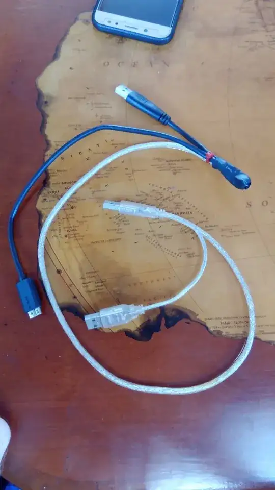

UPDATE AND SOLUTION: Ater checking the current a hard drive gets from a computer or from the wall output (0.7A-1A) and comparing it with the powered USB hub on the RPi (0.3A-0.4A), we figured out the hub was probably crappy (even if we paid 20$) and might have a resistance in there to prevent too much power from getting in. So we built our own "redneck engineering" USB hub in the picture below, which is basically just the regular HDD black USB cable soldered to GND and VCC of the transparent dual USB cable from an old HDD (One would probably be enough). Then we plug the transparent cable in an external USB source.
The only downside of that issue is that even when the RPi is unplugged from its powersource, all the USB devices (like the screen) are still getting power from that transparent cable. hand-made USB power
