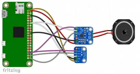

I have a Raspberry Pi Zero and I am using the Adafruit I2S MEMS Microphone together with the ADAFRUIT I2S 3W CLASS D AMPLIFIER BREAKOUT - MAX98357A.
I did follow the two respective tutorials and I got both the mic and the speaker working. However, I do need to disable the microphone or the amp + speaker won't work.
There seems to be a conflict regarding the I2S bus.
