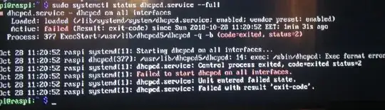

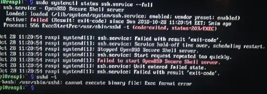

I accidentally changed my hostname to an invalid one, containing ".". I managed to change the hostname back to a valid one but the dhcpcd and ssh service fail to start. If I ping my RPi from another computer I get "Destination host unreachable". Also, RPi seems to not be connected to the network. I already tried changing to different hostnames using raspi-config. Nothing worked so far.
I use an ethernet cable connected to the RPi with interace eth0. I have Raspbian installed on a Flash Drive.
dhcpcd
ssh

Please post text and not images. Just the important error message is stripped-down: dhcpcd(377): ... Exec format error ???. With lack of further information I guess dhcpcd has problems to read its configuration file /etc/dhcpcd.conf or maybe there is anywhere a cached malformed hostname. Please check if there are some unknown entries in dhcpcd.conf. You can look at the journal if there are some related errors shown with:

As I have learned from the comment it is very likely that /sbin/dhcpcd and /usr/sbin/sshd are broken or have been replaced. I also see just now that the error message:
Exec format error
is given on dhcpcd AND on sshd. Following the answer from @Valentin R. is a good advice for both packages. You can also first try to reinstall them with:
rpi ~$ sudo apt --reinstall install dhcpcd5
rpi ~$ sudo apt --reinstall install openssh-server
