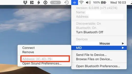

Optional: Get the address of the the bluetooth device
On my mac I hit while pressing the bluetooth icon in the status bar.
