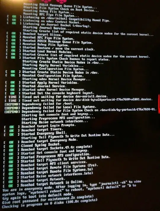

I did set the OTP usb boot flag in the mean time, meaning the smaller SD card is no longer necessary. This makes the whole process much easier. What I try now is the following:
First copy the whole SD card to the SSD drive:
sudo dd if=/dev/sda of=/dev/sdc
If I attach the resulting SSD to the RasPi it boots just fine and everything works. But if I try to grow the /dev/sdc2 partition (rootfs) using GParted, it won't boot successfully anymore. Here is a screenshot showing the problem(s):
Boot Error Messages
How can I resize rootfs without causing this problem?
