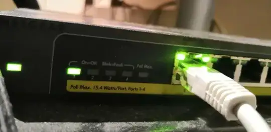

My PoE switch has a label which states that it can supply a maximum of 15.4 watts per port: enter image description here

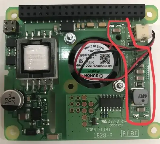

Version 2 of the PoE hat released a few months ago works flawlessly; version 1 had big issues. With the V2 POE Hat, I can even drive an external 1TB USB hard drive directly without a powered USB hub from the USB ports using only the power from the switch. And the Pi will stay up indefinitely until I take it down. To validate that you were sold the newer v2 PoE hat, look for a mezzanine card on the underside as shown in below picture.
If you DO have the V2 PoE hat, check Ethernet cable length in relation to its' AWG size is sufficient to squirt power the longer distance. Thin cables have smaller conductors and are less performant as distances increase from the PoE switch. Understanding AWG Ethernet cable sizing: a LOWER number offers a THICKER conductor with lower resistance. ie an AWG 24 Ethernet cable is THICKER than an AWG 26 one. It's easy to forget about the cable between the PoE switch and the Pi ;-) PoE Hat v2 incorporates a mezzanine card to fix the issues in the v1 model
