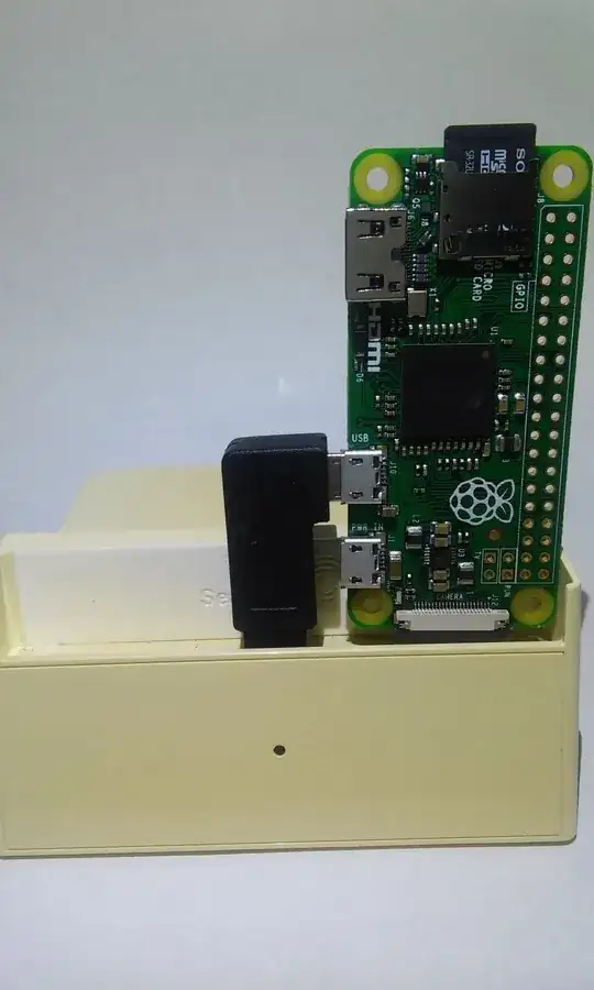

I have a FreeAgent DockStarTM Network Adapter running on a debian Stretch OS with its rootfs partition on an external USB memory stick. Using this Ethernet Gadget tutorial and this USB Mini 5Pin Female to Micro 5Pin Male 90 Degree Angle Adapter to connect a Raspberry Pi Zero (Rpi0) to one of USB ports on the Seagate Dockstar as seen below, I managed to configure my Seagate Dockstar to bring up the usb0 interface (not be confused with a USB connection) as shown below.

So far, my Rpi0 managed to secure a dual-stack of IPv4 (private) and IPv6 (public) Addresses from my router (see above with all IP Addresses disguised). I have no problem to SSH into my Rpi0 from a computer within the same private LAN behind the same router and/or from a computer outside my private LAN with an IPv6. However, if I reboot my Rpi0, it will break the USB connection. In the process of booting up from the reboot, the Rpi0 will try to establish a USB connection with the Seagate Dockstar and this causes the whole rootfs vanishes. So, until I power cycle the Rpi0, I can no longer execute df, ifconfig, ls, etc., except echo and exit. Right before this happens, I managed to dump out messages from dmesg (see below). I don't know if this problem is caused by the g_ether kernel driver. If you know the solution to this issue, I sure would appreciate your help.

user91822
  • 422
As far as I see I would suspect a hardware problem. I seems this Ethernet Gadget of the Raspberry Pi Zero violate the connection of the USB storage where the Seagate Dockstar has its operating system. If this breaks then the Dockstar will not work anymore and you will see the errors you have reported. It cannot find its essential system programs. Try to isolate the problem with a powered USB hub first between RPi0 and Dockstar, then between USB drive and Dockstar and also USB drive and RPi0 both connected to the hub.
If this doesn't help I would use an ethernet to USB dongle or even a Raspberry Pi 3B(+). The price shouldn't make a big difference with all the additional peripherals you need with the RPi0.
