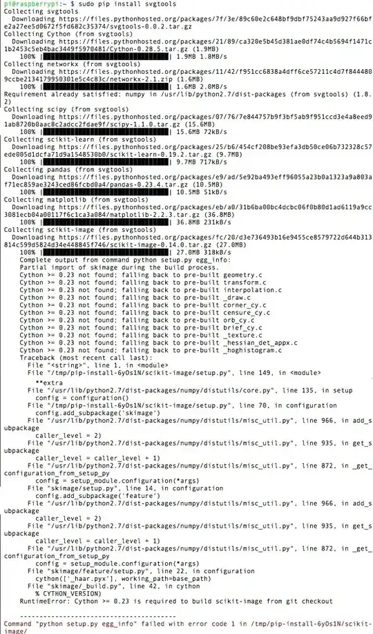

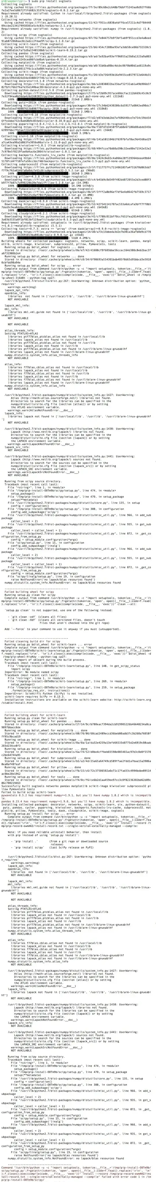

also worked without a problem. The problem I'm facing right now is svgtools. Here are the logs of my first attempt:
I had to use a picture in order to stay in the 30000 character limit, sorry My little understanding told me that I had to install the latest version of Cython. I did that with Sudo pip install Cython and no problems. However now I'm getting different problems when trying to install Svgtools.
From that output I get that SciPy is missing and the wrong version of numpy installed.

Where possible, installing packages through apt will save you a lot of trouble. Numpy and SciPy (note the -Py, not -Pi, as it's Python—not specifically Pi related) both have a lot of dependencies, and Pip generally tries to build the code directly rather than using pre-built packages as apt will.
The dependencies of svgtools are listed in the requirements.txt file of their repository. They are:
networkx
numpy
scipy
scikit-learn
pandas
scikit-image
So, you can try installing all of the above from the package manager:
sudo apt-get install python-networkx python-numpy python-scipy python-sklearn python-pandas
(scikit-image is not in the repositories so will have to be installed through Pip)
It may be wise to try to pip uninstall ... for any packages you have previously installed first.
