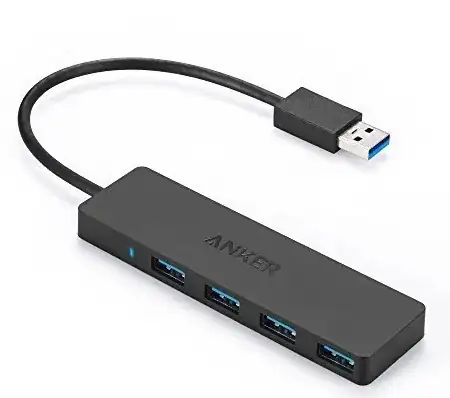

I found a nice little 4-port hub that works just fine with the Pi3B and relies on the Pi for power. With a 5V 2.5A mains power supply on the Rpi, it is rated to supply an aggregate of 1.4 Amps on the USB ports. That power can pass through this adapter. The other reason to use mains power is for peripherals that need it, as shown below.
This works with keyboard and mouse and flash drive as-is.
Here it is: 4-port USB Hub on Amazonenter image description here
The only trouble I have had is when I tried a Passport drive on it - it simply didn't work.

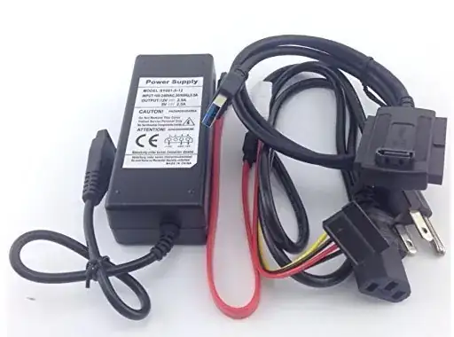

But it works for my 1TB laptop SSHD with a SATA USB adapter and external AC mains SATA power supply. The power supply came with the SATA adapter. This isnt the exact brand as mine but it looks the same: SATA to USB with power supplyenter image description here
I haven't had need to try more than one drive like this, but have no reason to think it wouldn't work.
