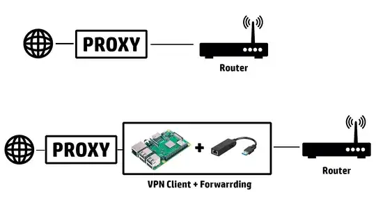

I got a Raspberry Pi and i would like to use it like a VPN client and forward the VPN connexion I want that complely transparency for user in my home. (I don't want that my familly have to set a gateway and DNS). I did a little schematic for understanding my goal.
Schematic of the project

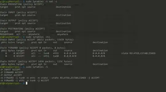

But I'm block, I configure a DHCP Server on the eth1 (the link between the Pi and the Router), I get an IP adress from the Pi (I try with a laptop before plugin the router). After that, I have some issue to forward the traffic beetween the VPN interface (tun0) and eth1.
This is my iptables rules: IP Tables Rules

Here I have made an ascii art how it should work.
                                       10.10.10.2                      +----------+   10.10.10.1
                                          /           vpn-tunnel       |          |      \
             bridge                   (tun0) =============\\   //========================\\
DEVICE ~.~.> ROUTER -------> (eth1)RPI(eth0) ------------> PROXY <---> | INTERNET | <---> VPN-SERVER
     \ wifi    D    ethernet  /           \    ethernet   /       wan  |          |  wan /
  (by dhcp)    H        192.168.1.1   192.168.10.60   192.168.10.1     +----------+   62.155.246.85
               C
               P
The RPi works as a router. Its port eth1 is on the same subnet than all other devices because it is bridged to the wifi on the router. The RPi needs a static ip address on eth1 because it must be addressed as default gateway to the vpn tunnel. The Raspberry Pi B2 has no build in wifi so we need the router.

For the first setup you should also don't set any rules in iptables and leave it complete transparent. iptables is a firewall and only restrict connections. When the network is running then you can setup your firewall step by step.
