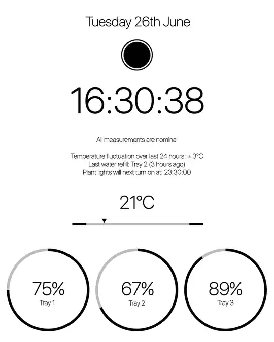

For some background, my project is quite simply 3 shelves of plants, each having it's own watering system, LED lighting and soil moisture sensor (there is also 1 thermometer located on the top shelf). The Raspberry Pi then monitors and controls the growing conditions for the plants. My aim is to attach a small (2-4 inch) e-ink display to the pre-existing setup and have it display a GUI which can show the user information like the humidity, temperature and time in a similar manner to my mockup below:
E-Ink mockup
However, I have found that there is not the same abundance of resources available for e-ink displays as there are for other displays such as LCDs.
My question is: How would I pipe my sensor data into the e-ink display and have it add graphic elements such as the percentage circle?
