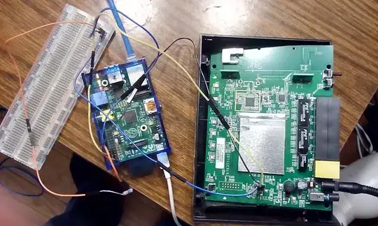

I don't actually need to debrick this WNR2000v3, I'm just trying to learn how to connect to an embedded device using a serial connection to see if I can do it.

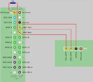

I believe I have setup the wires so that they correspond to the following diagram (please let me know if I have not)...
Diagram from https://johanbijker.blogspot.com/2012/07/tp-link-mr3420-serial-connection-with.html
I found this in a blog about serial connecting to another router using minicom.

Found additional information about which pin was which on the UART of the router from this page:
WNR2000v3
The serial port is at JP1: 115200 8N1 at 3.3V. Pads are, from left to right with the ethernet ports on right: [Vcc] [Tx] [Rx] [GND]
Wiring Setup
When I used minicom I did receive a bit of output, but eventually it falls apart, and I'm unable (as far as I can tell) to communicate back to the serial terminal:
