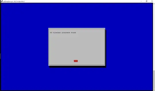

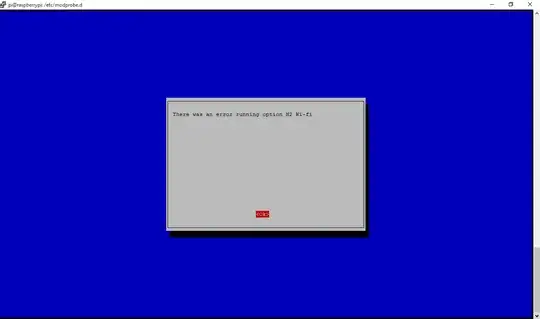

EDIT in raspi-config when I enter network options enter image description here

This is obviously the wrong kernel you are using. Please use a fresh flashed SD Card with the image I have done. Then everything works as expected (have tested it). You will see wlan0 with ifconfig and you can scan the wifi network with sudo iwlist wlan0 scan. If this does not work on your raspi I only see two possibilities:
  1. Your Raspberry Pi is broken
  2. You do not use a Raspberry Pi 3 model B.
