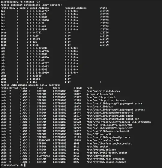

Terminal results from netstat -ln.
<code>netstat -ln</code> <--**RESULT:**

You can verify that this disables nmbd with netstat -ln | grep 137 and netstat -ln | grep 138. Ports 137 & 138 are two ports used by netbios.

pi@raspberrypi3b:~ $ netstat -ln | grep 137
udp        0      0 192.168.1.255:137       0.0.0.0:*
udp        0      0 192.168.1.27:137        0.0.0.0:*
udp        0      0 192.168.1.28:137        0.0.0.0:*
udp        0      0 0.0.0.0:137             0.0.0.0:*
pi@raspberrypi3b:~ $ netstat -ln | grep 138
udp        0      0 192.168.1.255:138       0.0.0.0:*
udp        0      0 192.168.1.27:138        0.0.0.0:*
udp        0      0 192.168.1.28:138        0.0.0.0:*
udp        0      0 0.0.0.0:138             0.0.0.0:*
