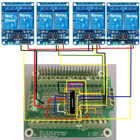

enter image description hereI have 4 Sunfounder 2 channel relays 7 of which that I'm using to control some things on my aquarium. I suspect that I may have wired them up wrong somehow though. The behavior I'm seeing is as follows;
if I open either Drain Pump/Fill Pump relay
  1. The corresponding relay opens but if the ATO relay is open, it will close.
  2. Closing either Drain Pump/Fill Pump relays has no effect on the ATO relay
If I close the ATO relay
  1. The Fish Feeder relay opens.
  2. Inversely if I open the ATO relay the Fish Feeder relay closes.
Sample code for opening and closing relays called from the command line
const Gpio = require('onoff').Gpio;
const drain_relay = new Gpio(7, 'out');
const fill_relay = new Gpio(8, 'out');
const feed_relay = new Gpio(14, 'out');
const ato_relay = new Gpio(18, 'out');
drain_relay.writeSync(0) //closes the drain relay drain_relay.writeSync(1) //opens the drain relay
Similar writeSync calls passing 0 to close or 1 to open the other relays are made.
These were just a couple of the anomalies I found. There could be more.
On my Raspberry Pi hat I connect the 4 pin GND to ground and VCC to +5V and IN1 and IN2 to GPIO pins. Could the signal be jumping pins on the hat? Or is there something else I'm missing?

I took the two hats off my Pi and started going through my wires looking for a loose connection or something. I found a 5v wire on my new hat that, while the solder joint looked good, the wire seemed to move pretty freely compared to the others near the solder joint.
While I was there fixing that I knew I had left a couple of the 5v and ground wires that went to the 4 pin connectors on the relay boards on my original hat when I moved the ULN2003A , the GPIO signal wires and the ULN2003A OUT to relay IN wires to the new hat. I decided to bring those 5v and ground wires over to the new hat as well. This way I have all my relay related connections on one hat and sensor related connections on the other.
After putting everything back together the relay lights no longer lit up on boot. Good!?! Maybe? My relays still weren't actuating with my commands. And now there are no changes to the LED lights. they just stay off.
I disconnected the 4 pin connectors from the relay boards and began checking them with the volt meter. I no longer had 5V across any of the VCC GND pins. But when I probed GND to IN pins and toggled the associated GPIO I still got a voltage reading between zero and 900mv.

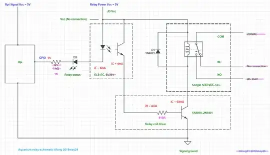

Your pictures don't labelled the connections. Perhaps you can let us know the wires connected to the relay modules.
Aquarium relays
Or you might to confirm if my guess below is correct.
aqua connect
I checked your photos and found the optocoupler 817C, and the resistors 1k and 512R. So I guess your connection is something like below.
Aqua schematic

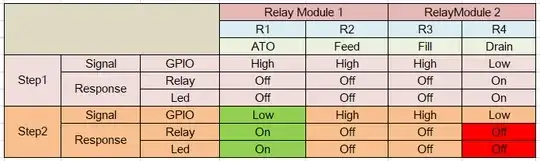

So is Step 1 below OK, Step 2 has a problem?
relay problem
In the above diagram, if GPIO is Low, relay is triggered/activated/switched "on", electrical circuit is "closed" (therefore electrical current flows), motor is switch "on".
Your "open" seems to mean my "on", your "closed" means my "off". I am still confused. Let me try again.
Do you mean that if you run the following statements:
drain_relay.writeSync(0) //closes drain relay (drain pump, drain LED on)
sleep 1 second
ato_relay.writeSync(0) //closes ATO relay (ATO pump, ATO LED switched on)
sleep 1 second
You expect drain LED turned on in Second One, then both ATO and drain LEDs turned on in Second Two. But the problem is that in Seconds Two, drain LED is turned off unexpectedly?

In your initial diagram you do not show a GND connection to the module for Relays 6 and 7.
Lack of that ground would most likely cause the entire rest of the circuit to misbehave in deterministic ways that will show up as a definite pattern.
The existence of the pattern is a clue; not necessarily the details of the incorrect behavior itself.

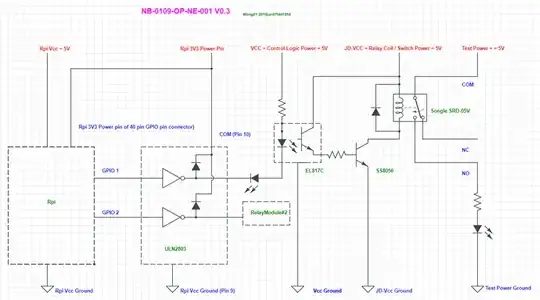

In the beginning the problem I was having was relays actuating by a GPIO OUT signal that was not directed at them.
On the Raspberry Pi Forum user pcmanbob pointed out that my relays were designed to be actuated by 5v but the GPIO OUT signal that I was using to actuate them was only 3.3V He suggested adding a ULN2003 transistor which I soldered onto the Pi EZConnect hat shown.
This was when I went to all relays closing at boot and none of them responding to any GPIO signal. They Just stayed on.

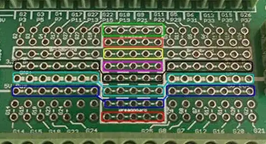

After some breadboard testing with the ULN2003 I was able to get the relays to actuate according to the appropriate command but when I moved the setup back to the Pi EZConnect hat all relays still closed at boot.
The cause was the way the breadboard section of the Pi EZConnect solder pin holes were laid out.
Pi EZConnect layout
All pins going across the breadboard section of the Pi EZConnect are connected. Therefore the ULN2003 was being shorted/bypassed between its metal tabs across from each other.
The fix for me was to switch to a different hat with no connection between pins and make my own solder bridge between the wires and the nearest metal tab of the ULN2003.
