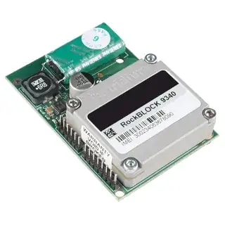

satcomm module
cost: $250
monthly fee: $15
https://www.sparkfun.com/products/13745
