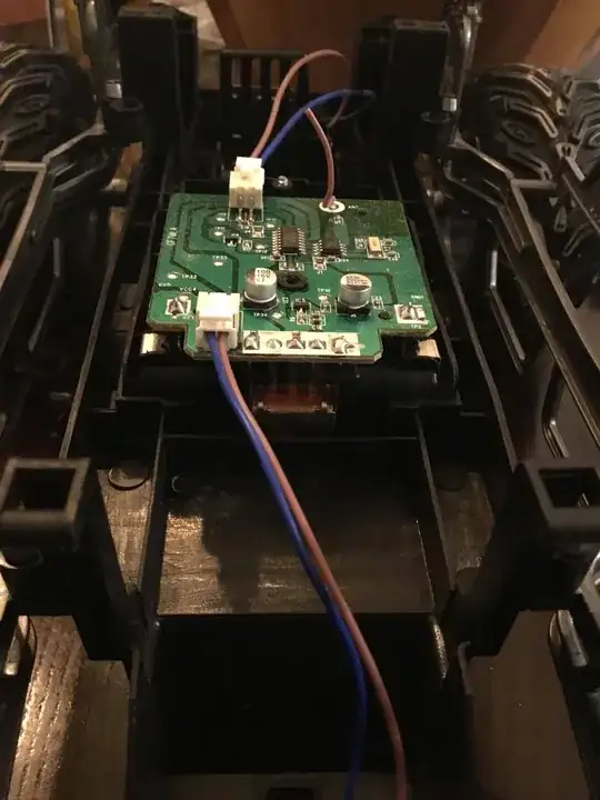

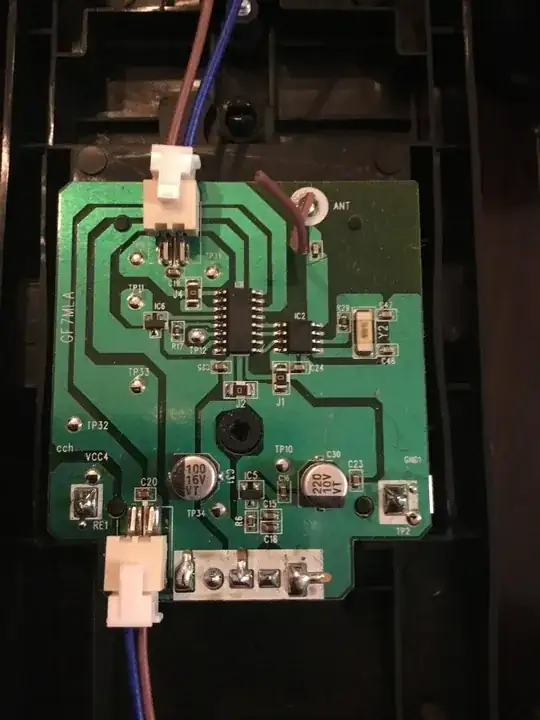

I’m a total newb with electronics but know my way around Linux/Python just fine. I’ve read many tutorials but none of them cover using gpio to control a RC car control board and I’m wondering what I need to make this work considering it’s a 6.4v battery connected directly through the board.Thanks for your advice in advance.enter image description here

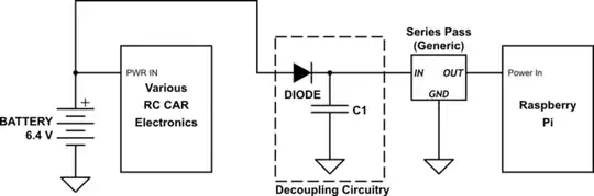

Finally, if you take the "single 6.4 vdc battery" route, keep this in mind: The RPi is sensitive to power fluctuations. Power fluctuations can cause some really odd behavior that might not be easily recognizable as such. To give yourself the best chance, consider decoupling the RPi power source. I've included a generic schematic below to illustrate "decoupling".
schematic
Seamus
