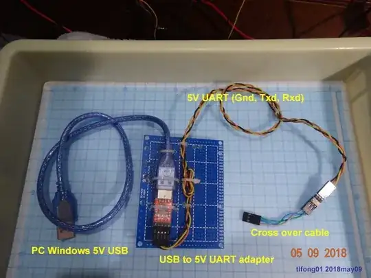

This answer describes how to transfer plain text between PC and RpiB, using a serial cable.
At the PC side, an usb to serial adapter can be used to converts PC's USB signals to 5V UART serial signals .
At the Rpi3 side, there are 2 GPIO pins: UART0 Txd, Rxd for data transfer at 3.3V level.
These Rpi UART signals at 3.3V should be shifted up to 5V, then PC and Rpi can communicate at the same logical level.
/ to be continued, ...
USB to TTL UART adapter
