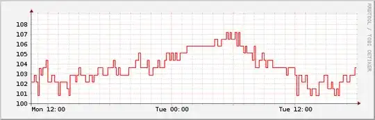

Other than that, this setup provides a wonderful opportunity to watch how your mains voltage changes over the time (using rrdtool), the numbers on the left are Volts:
voltage changing over the last 24 hours

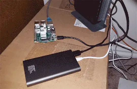

A low cost solution is to use a USB battery pack. A decent battery can power a pi for a number of hours depending on usage and battery capacity. Here's an example of a DSL modem charging a battery that is powering a pi. In the example, the modem can reset and the pi won't get interrupted.
The battery needs to be rated at 5v and have a high enough input and output amperage to remain charged and power a pi respectively. Bigger capacity batteries will supply power longer.
