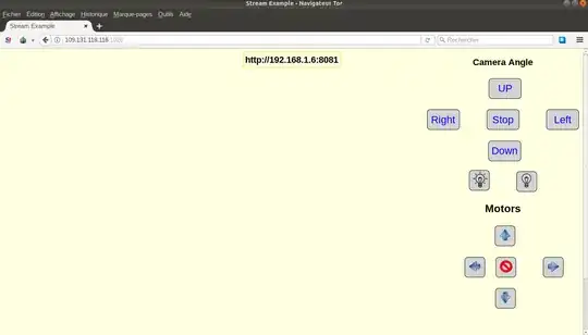

I'm trying to make a server with motion , lighttpd and cgi scripting bash, everything is fine excepted from outside of my network (internet). Those are my files and log. Somebody can help me please? I will really appreciate
page web on server

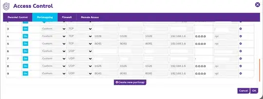

Ports in my router

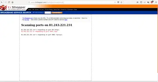

ports do not respond to requests
