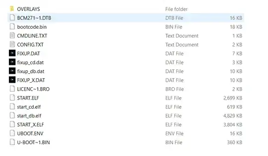

Looking at the SD card it looks like its not flashing properly but I'm not 100% sure. I've taken a screenshot of windows explorer to show what the SD card contains.
SD Card Contents
As mentioned earlier both SD cards can successfully boot from the Raspbian OS and when booting this image the ACT light flashes but nothing at all when trying to boot from Android Things.

Android Things hasn’t been updated for the Pi3B+ yet.
