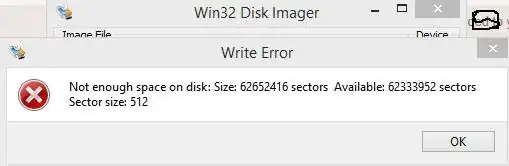

I've been careful to buy the same Samsung 32GB SD cards for all my Rpi3 systems to avoid the dreaded Win32diskImager size error.
All of the Rpi images are stored safely in the NAS as .img files.
When it is time for a new one, I go back to the Orders button in Azon and find the most recent one where it says "You have bought this previously - View Order" - and I buy it again.
They visually look the same, with identical markings:
So now as I am trying to write that image (to any of several of the same-looking cards), they all are showing the exact same error - same numbers.

Upon further investigation I have discovered that only this (first) particular image is of a different size:
The one at the top is the one I am trying to restore.
It seems pretty obvious that in the beginning, before I knew to match the images to the cards, that I allowed NOOBS to expand to a larger card.
If that SD card is still in inventory it must have gotten flashed with one of the other images. Or it may be a round-file item - some of my systems are thermally stressed so it happens now and then.
Storage of the .img files is definitely worth the effort. Especially since the NAS can do compression on the image files while they are in warm storage. 7z and ZIP are about the same: Storage requirement is roughly 15% of original size.
Now, I never use NOOBS. I simply clone one of the systems which is most similar to what is needed in the new one, then shut down the original long enough to log into the clone and change the hostname and static IP.
With identical cards the .img included partition sizing was not an issue.
Thought I had all the bases covered.
Until now.
QUESTION: Is there a way to do this image restore?

The SD Cards are NOT exactly the same - they obviously differ in size, and this is normal.
The imaging programs copy BLOCKS from one device to another, as do dd. Win32diskImager is probably not the best, it had a number of issues with Foundation images, and Etcher is recommended.
I use dd to backup my cards, they can be restored to the SAME card, and if you are lucky can make a copy, but this is NOT a reliable duplication method.
See Can a Raspberry Pi be used to create a backup of itself? which has a backup strategy, and lots good discussion (unfortunately a few uninformed posts).
Raspbian has an in-built SD Copy utility which can copy to smaller cards (which can be quite slow).
It is simple enough to create empty space at the end of the card to allow duplication, and many people have discussed this.
Your posted solution may or may not have accurately duplicated your card image. As no errors are reported it might be OK, but I would check the number of blocks on each.
PS your "wipe the partition table and boot sector" will do no harm, it will just use some of the SD Card write capacity and move a number of 4M blocks to other parts of the card, but they will still be there until re-used - this is just the way flash storage works, and is part of the wear levelling process.
To answer your other questions; it is possible to mount the image on any Linux system (including the Pi) and use normal imaging programs to resize partitions. This can be done from the command line or using GParted. (Your image looks like it is NOOBS, and is wasting 1.2GB of your card.)

I met this error in win32diskimager, I also to decrease the image file, but it doesn't work.
I have tried etcher in windows, it also report destination sd card is too small. so I try dd from git bash, it works because dd just copy data, don't care size.
