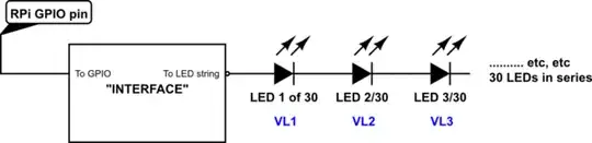

I need to control about 90 LEDs with a Raspberry Pi. I am thinking of doing with with 3 chains of 30 LEDs, so I can control each set of 30 LEDs independently (turn 30 on and off at a time) and change their brightness (using GPIO.PWM). Do I just need to just have one resistor at the end of the chain of LEDS example (gpio_resistor_led_led_led_led_led_ground)?
I am thinking of using a Pi Zero and these LEDs
should this work?

Driving 30 LEDs in series is definitely "do-able", but you will need to spend some time and effort designing or selecting an interface circuit. This interface circuit will be positioned between your GPIO pin(s), and the series string of LEDs as shown in the schematic below. Its realization may require more than one item of hardware.
schematic
Since LEDs are current driven devices, your interface should be a current source instead of a voltage source. In other words, it will regulate its current output at a particular value - a specification determined by the LEDs you choose, and the brightness you want. From the LED page on Amazon you referenced, the maximum drive current required is 20 mA, and the maximum forward voltage drop is about 3.5 v. Using Kirchoff's Laws and doing the math yields the following:
  • the constant current interface must source 20 mA
  • the compliance voltage of constant current interface must be 30 x 3.5 = 105v!
And so that means that a device in this class might be appropriate for the interface in your project. Since the output voltage exceeds 70v, it also means that you'll need to investigate the rules and regulations pertaining to its deployment.
But your interface design isn't complete yet (assuming you're using a device similar to the one above) as you won't be able to interface this device directly with a Pi Zero's GPIO. Something like a solid state relay may be required to complete the design of your interface.
Of course this is just a brief outline. It neglects several details, but hopefully gives a fairly thorough answer to your question of "should this work?". Please post any follow up questions here, and good luck with your project.
