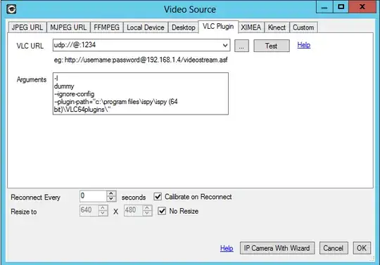

The most stable settings for me are is to use a script file, fifo and the psips script to dump mpegts video over udp
rm -f "$fifo"
mkfifo "$fifo"
raspivid -ex auto -mm matrix -w 720-h 576 -fps 10 -t 0 -b 1000000 -o - | psips > "$fifo" &
ffmpeg -y \
  -f h264 \
  -i "$fifo" \
  -c:v copy \
  -map 0:0 \
  -f mpegts udp:192.168.1.88:1234
Then I used iSpy vlc plugin enter image description here
When I try to use rtmp with nginx then iSpy crashes allot and it totally floods my WiFi.
Using udp means the Pi will dump the frames to the target machine and neither the source or destination is going to cry about lost frames saving allot of processing power. Using 576p the pi hardly uses 1% cpu and the cpu usage on iSpy is halved for processiing motion.
