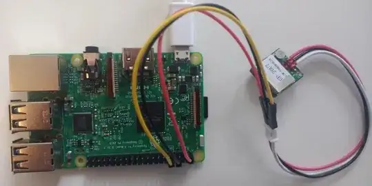

So I'm really new to Raspberry Pi (3), and want to track the device position. Therefore I ordered a GP 20u7 GPS receiver.

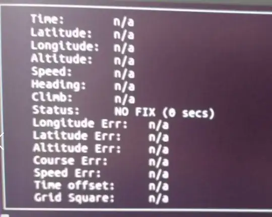

I connected it as shown below, set up the deamon (gpsd), configured the ttyS0, but no succes. I do have NMEA messages coming from /dev/ttyS0, but without values for lat and lon. See also the included figure for cgps.
So my guess is that I'm doing something very wrong. Do I need more hardware components to make this setup? I can't find a clear answer online. I thought the receiver would be enough...

Have you tried it outdoor? GPS has very low to no reception indoors. Also you have to receive a signal from at least 4 GPS satellites. Smartphones overcome this issue by using the WiFi and cellular strength and a map service where each WiFi network and cell is mapped to GPS coordinates.

If your setup matches the image -- I do not see how you can be getting NEMA sentences via ttyS0 -- you have the GPS transmit connected to the RPi UART transmit. It needs to be on the UART receive -- next pin.
Did you verify at the command prompt?
sudo cat /dev/ttyS0
Antennas are usually not necessary -- I get data without one.
