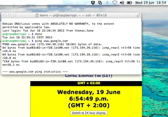

The thing is - it seems to be an entire day out and I think that it is configured to the correct time zone. See the following screenshot:
Time Zone
Notice the date in the top right hand corner and compare it with the date in the terminal and with the browser behind showing the date and time. Notice also that I pinged google and it came back fine so it has an internet connection.

ping to google looks just fine, but what results you get from ntptime ?
$ ntptime
ntp_gettime() returns code 0 (OK)
  time d56c8aa0.a60e5194  Thu, Jun 20 2013  4:53:04.648, (.648656024),
  maximum error 817308 us, estimated error 952 us, TAI offset 0
also, for changing your time zone, the recommended way is running sudo raspi-config, then using 4 Internationalisation Options and I2 Change Timezone to do the trick instead of manually editing config files.
