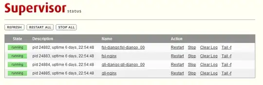

supervisord is such a monitoring daemon. It can launch processes when it starts (though this can be disabled, so processes are manually started). If a process crashes, it will be restarted.
As a bonus, it has a nice web interface: enter image description here
