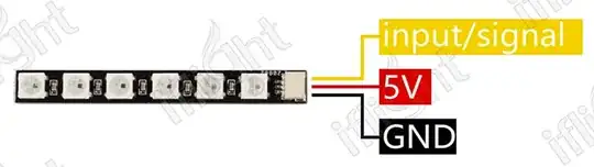

Anyways the LED strip that I bought and plan on using is this one: enter image description here

Is the input/signal from the first diagram (LED strip that I got) a PWM signal? I assume it is otherwise I have to rephrase the title of this question. This confuses me because the LED strip is digital and PWM is analog? Moreover there are other digital LED strips that have 4 pins like this one:enter image description here Does that digital LED strip uses PWM as well? Sorry I am new to the embedded world I am probably wrong on this.

PWM (Pulse Width Modulation) applies to digital as well as analogue signals.
Individually addressable LED strips, such as you want to use, are not controlled by PWM signals. They are controlled by a bit stream to set the RGB values of individual LEDs.
You will not be able to send any meaningful data to such a LED strip until the Pi has booted, i.e. you will have a 14 second delay or so.

like joan said, PWM is technically digital. it works by flashing voltage on and off very very fast to simulate analog.
you can not control a digital led strip before the raspberry pi boots, although you can just after it boots by adding your script to the end of /etc/profile or /etc/rc.local . you could, though, by a seperate (analog, maybe even flashing!) rgb led or strip and wire one of its colors to the 5v and GND pins or the rpi, so it turned on right away, then once the rpi is fully on you could activate one of the other colors to turn, say, blue into purple.
