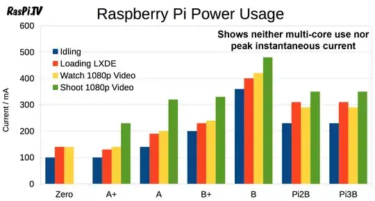

This is values from a specific setup, just here for reference. enter image description here
http://raspi.tv/2016/how-much-power-does-raspberry-pi3b-use-how-fast-is-it-compared-to-pi2b
I would recommend to meassure the power on your setup and calculate from that. And I would also recommend to search for "power conservation".
