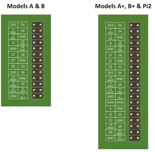

P5 Header pinout, bottom row (for the older ones, without 40-pin J8)
The new header can provide a second I²C channel (SDA + SCL) and handshake lines for the existing UART (TxD and RxD), or it can be used for an I2S (audio codec chip) interface using the PCM signals CLK, FS (Frame Sync), Din and Dout.
But then, I2S is not mentioned in the Model A+, B+ and B2 section on the same page, where the 40-pin header connector is featured (which is apparently the same as the J8 connector in the Raspberry Pi 3 model B).

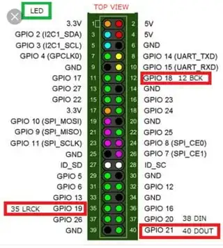

i2s on Raspberry pi 3 model B : Raspberry Pi • RuneAudio Forum mentions:
  • J8 pin 12: BCK/GPIO 18
  • J8 pin 35: LRCK/GPIO 19
  • J8 pin 40: DOUT/GPIO 21
runeaudio-tapatalk

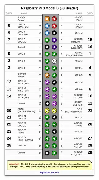

The Pi4J Project - Pin Numbering - Raspberry Pi 3 Model B has a pinout image that mentions:
  • J8-12 GPIO 1, PCM_CLK/PWM0
  • J8-35 GPIO 24, PCM_FS/PWM1
  • J8-40 GPIO 29, PCM_DOUT
Apparently, it mentions the PCM functions of the pins (instead of their I2S roles) - but then, the GPIO numbering is totally different from the previous two examples? Here is its diagram:
pi4j.com

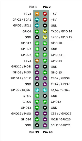

On this eLinux pinout, no I2S/PCM functionality is mentioned, but instead:
  • J8-12 GPIO 18
  • J8-35 GPIO 19, MISO
  • J8-40 GPIO 21, SCLK
eLinux
Other pinouts, like https://www.element14.com/community/docs/DOC-73950/l/raspberry-pi-3-model-b-gpio-40-pin-block-pinout or https://www.jameco.com/Jameco/workshop/circuitnotes/raspberry-pi-circuit-note.html don't even mention this alternative functionality - and apparently, I cannot find such a pinout diagram on the official site (apart from https://www.raspberrypi.org/documentation/usage/gpio-plus-and-raspi2/README.md which doesn't list any pin names/functions)
