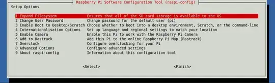

The Raspbian Approach is as follows, I would duplicate this approach. raspi-config provides a resize script that uses parted (a command line utility) to resize the filesystem on boot. This script is located in /usr/lib/raspi-config/init_resize.sh
- Create image with minimal fs size
- Specify in
/boot/cmdline.txt the option init=/usr/lib/raspi-config/init_resize.sh
- On first boot this script will execute and delete the line from
/boot/cmdline.txt
Before: dwc_otg.lpm_enable=0 init=/usr/lib/raspi-config/init_resize.sh console=serial0,115200 console=tty1 root=PARTUUID=23668fa2-02 rootfstype=ext4 elevator=deadline fsck.repair=yes rootwait quiet splash plymouth.ignore-serial-consoles
After: dwc_otg.lpm_enable=0 console=serial0,115200 console=tty1 root=PARTUUID=23668fa2-02 rootfstype=ext4 elevator=deadline fsck.repair=yes rootwait quiet splash plymouth.ignore-serial-consoles
You can choose to use the default raspi-config provided resize script by including the package in your base image, or, you may choose to create your own script to package with your image, using the same approach to do whatever other first-boot configuration you wish.
