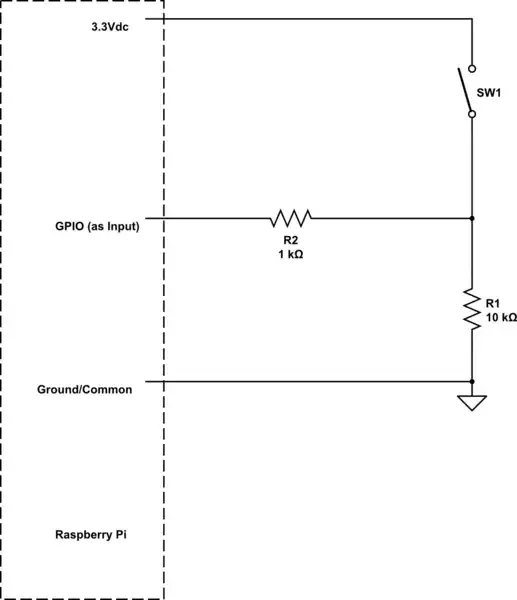

See my answer to another question here regarding the use of an interposing relay.
In the answer I posted I made mention to use a pull down resistor, and a current limiting resistor in series with the GPIO. This would look something like this.
schematic
R2 serves to limit the current going to the input. We don't need a lot, we are simply looking for a voltage (as measured across pull down resistor R1). I typically use a 10:1 ratio, but for R2 you can use a lower value like 330 ohms.
SW1 represents the contact of a relay, the coil not shown. Pick a relay with a 12Vdc coil, these are common.

It is simple to interface a higher voltage indicator to the Pi, provided they can share a common ground connection.
Using relays is sledgehammer solution which introduces a number of other problems.
The simplest approach uses a voltage divider. Do NOT attempt to produce 3.3V, anything over 2.2V will reliably trigger the Pi (my tests indicate 1.3V is OK).
If the source is not clean DC you can implement various protective measures - either a diode clamp to 3.3V or a total isolation e.g using an optoisolator.
