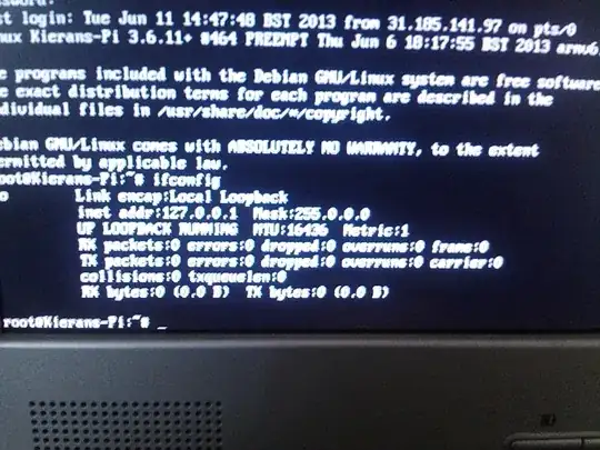

Here is the output when I run ifconfig. Sorry about the quality. It's legible.

So it seems that the Raspberry Pi (or the Raspbian distro) cuts out the internet after a period of inactivity.
This is easily fixed with the following cron job:
* * * * * ping -c 1 www.google.com

I set up networking in a hurry following this wiki on how to setup the /etc/network/interfaces that I got from here which confused the bejayshus out of me even though i've been setting up networks for years.
This problem is caused by incorrect configuration of the /etc/network/interfaces. Assuming that you have a wired connection,
Try using a configuration like:
auto lo
iface lo inet loopback
allow-hotplug wlan0
iface wlan0 inet manual
wpa-roam /etc/wpa_supplicant/wpa_supplicant.conf
iface default inet dhcp
auto eth0
iface eth0 inet static
address 192.168.1.4
netmask 255.255.255.0
gateway 192.168.1.1
up route add default gw 192.168.1.1
down route del default gw 192.168.1.1
This I found worked for me as a starting network configuration template. You will need to alter the ip addresses appropriately for your network. If you use DHCP, try:
auto lo
allow-hotplug wlan0
auto eth0
iface eth0 inet dhcp
I hope that is enough to get you started. After changing these settings and rebooting the raspberry pi, the problem disappeared.
