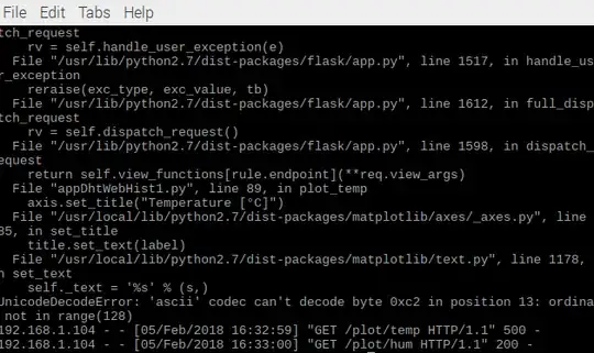

FYI, the final result must be displaying 2 historical chart images based on my database. and sure mine was displaying it perfectly but why its only display 1 chart ? the humidity chart. and when i check the messages i got error 500 http on my terminal while the other GET method were 200 when flask running
Error 500 HTTP GET

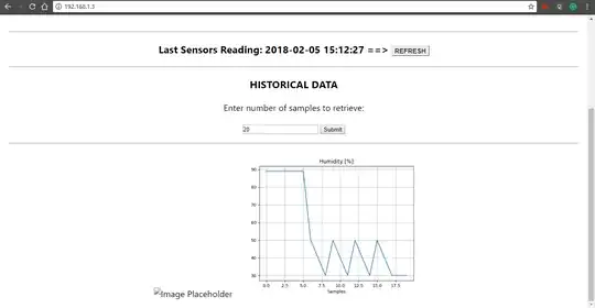

Result on Web
I don't understand whats the problem, the humidity data were perfectly displayed but why the temperature data were not. in fact humidity and temperature is on same table.

I see this kind of error often, when I use Python code that is written for Python 3 with an Python 2 interpreter / Runtime (or vice versa). They change the way String literals are interpreted when printing/serializing (asscii, UTF-8). Please compare your python installation with that of the original author. Is is the same? I'm pretty sure that's the problem.
In the code, find the line with Temperature and remove the degree symbol so it looks like this "Temperature [C]". Could be your version of python but whatever the reason, it's unable to decode that symbol. Try searching "python can't decode 0xc2" in your favorite search engine.
