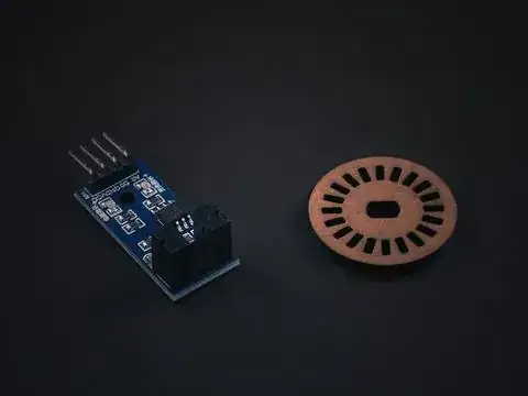

i would suggest to go for two stepper/servo motors depending on the rpm and rate of commands you plan to give to the motor with Ir speed controller enter image description here
TO choose motor click here Motor is completely application specific and output dependent weather precise movement or timing controlled movements
