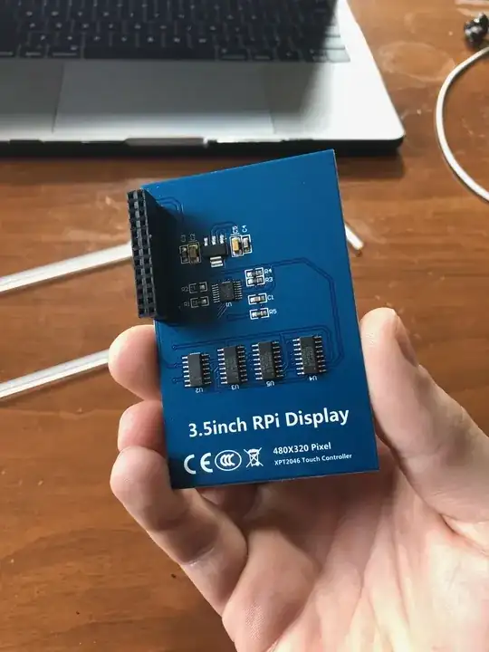

I made the mistake of buying a cheap 3.5in 480x320 TFT display from a Chinese retailer. its unbranded, customer service is awful, no software was sent with it. I was sent a file in Chinese that was supposedly the driver. it never could fully download. the connection always timed out it took so long. ive looked into the Waveshare driver but unsure if it would work or not. any ideas? image is attached. rpi generic touchscreen

I've bought the same display. Here are my successful attempts to make it work on a RaspberryPi 3 B+ running Raspbian Stretch.

If you have a Dispaly as on the Image above, then:
git clone https://github.com/Elecrow-keen/Elecrow-LCD35.git
cd Elecrow-LCD35
sudo ./Elecrow-LCD35
This is tested on a RaspberryPi Zero with Raspian stretch. Remember that after a kernel update you have to rerun the installer.
