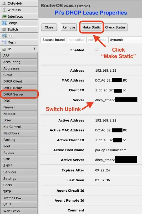

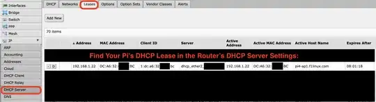

I go to the "LEASES" section of the DHCP Server and find my Pi:
Screenshot1

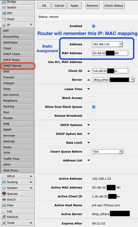

After clicking the Pi's lease, I'm presented with the option to "Make Static":
Screenshot2
Having made the "IP:MAC Address" mapping static, I can change the properties of the lease if I care to:
Screenshot3

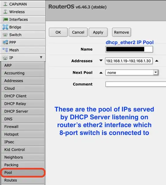

Now let's review the IP Pool being served by the DHCP Server listening on ether2 that the switch is connected to is serving 192.168 or 10.0 IPs:
Screenshot4
