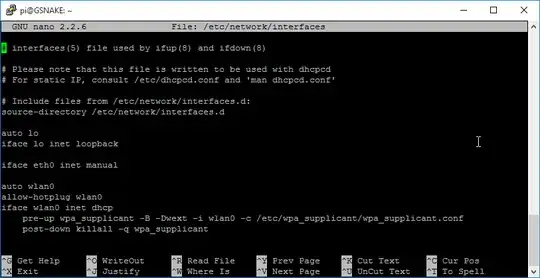

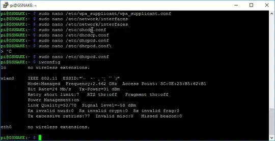

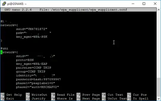

I connected my rpi to an enterprise wifi network and it looks connected. Still, there is 100% packet loss wheter I am trying to ping google.com or 8.8.8.8
I configured etc/wpa_supplicant/wpa_supplicant.conf and /etc/network/interfaces as well.

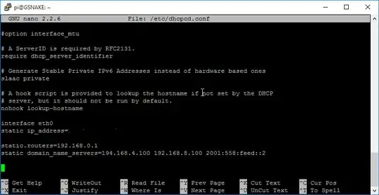

In addition to everything stated above, I edited dhcpcd.conf setting an static ip on my eth interface to connect the rpi by using putty and ssh. Beforehand, the connection was refused.
Is the static ip influencing by any means the wifi connection ?
