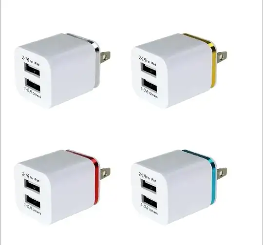

It is recommended to keep the power separate. Unless you have an adapter that provides two USB sockets like one below. These power adapters are cheap. Also would like to add that not all adapters deliver the power as marked.

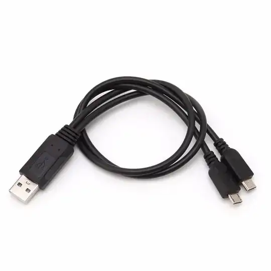

If you still are too desperate and want to use one USB power port to power you Pi and your through hole board, you can also use a power splitter cable like below; there won't be any need to modify anything, just add a micro USB connected to your through hole board: enter image description here
