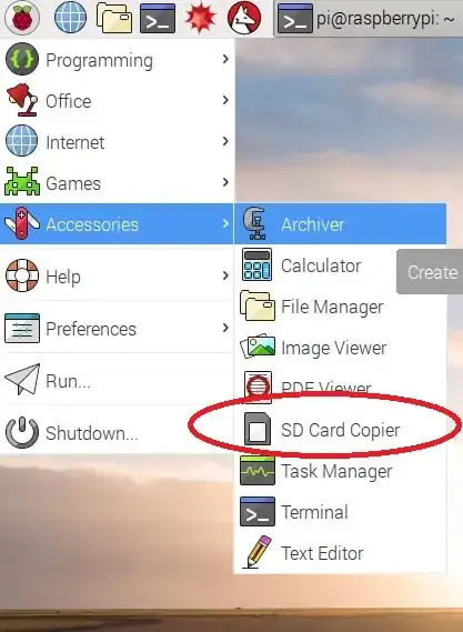

In case your OS is Raspbian, I'm wondering why you just don't use the built-in copier?
Print screen
