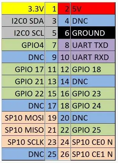

You could use a USB to UART connector, and connect that to the GPIO (which I tried here). That would be a serial communication. Then do the following:
  1. connect TX and RX pins from the serial port to the PI
  2. Connect the ground pins of the serial connector and the PI
    Diagaram is as follows:
    Pin Diagram
  3. run this in the PC terminal: screen /dev/ttyUSB0 115200
  4. Turn the PI on (you need to turn it on when the serial port is connected and minicom is running, otherwise you wont see any output).
  5. You should now see the boot sequence in your terminal, followed by a login screen.
Or you could communicate using the /dev/ttyAMA0 device on the PI, and (usually) the /dev/ttyUSB0 device on the PC.
