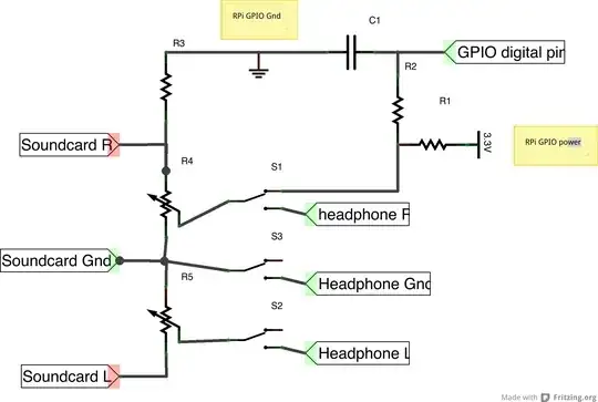

Here's the circuit I'm using:
R1=100k, R2=50k, R3=10k, C1=0.1uF
fritzing circuit schematic

I've found a workaround, but would still love to hear an explanation for the behavour exhibited above..
After a bit of experimenting, I found that eliminating R3 got the voltages within bounds of the GPIO threshold states. When the switch was open, V at GPIO was 2.85, when closed, V was 0. The problem was that every time I connected my headphones, I would hear the loud pop from the high dc offset which is somehow created by the interaction of the headphone amp and gpio pins. Not good for ears or headphones; I don't know what it might do to the life-expectancy of the Pi.
I've decided to keep R3, but bypass the headphone amp, and use a 1k log pot to give volume control. Sound quality is still quite high, and there are no noises when connecting or disconnecting.
I would still love to hear any solutions or explanations for the behaviour exhibited by the circuit with the headphone amp, but for anyone else who wants to have a headphone sensing jack for their Raspberry Pi, here's an updated diagram. The kind of jack I'm using is 3 conductor 4 contact, like this one. and I'm using a 1k dual gang log pot, such as this one.
Here is my final circuit, same values as before, but with the added 1k pot. The switches just represent the behaviour of the headphone jack.enter image description here
