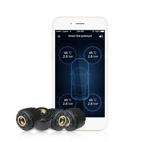

I'm working with a Bluetooth TPMS Sensor (TP630).
Here I have some important information about the sensor:
Description:
➤ Bluetooth Transmit Power: 0dbm MAX
➤ Processor: 8-bit MCU / S08 core, ARM M0
➤ Battery capacity: 140mAh (CR1632)
Specification:
➤ Tire pressure monitoring range: 100-900kpa
➤ Tire temperature monitoring range: -30 ℃ to +80 ℃
➤ Bluetooth operating frequency: 2.4GHz
➤ Sleep current: 2.4uA
➤ Working temperature: -30 ℃ to + 80 ℃
➤ Tire pressure monitoring accuracy: ± 10kpa
➤ Tire temperature monitoring accuracy: ± 3 ℃ enter image description here
What I want is to get Pressure and Temperature data from the sensor while is installed in the tire with a Raspberry Pi 3.
The app has the options to select the units that you want from the sensor: Temperature: Celsius - Fahrenheit Pressure: Bar - Psi - kpa
I'm currently reading data selecting Celsius and Psi units.
I've tested with the Android App and also with the RPi3 working with BlueZ 5.47 with great results, because I can receive data from the sensor using sudo bluetoothctl.
