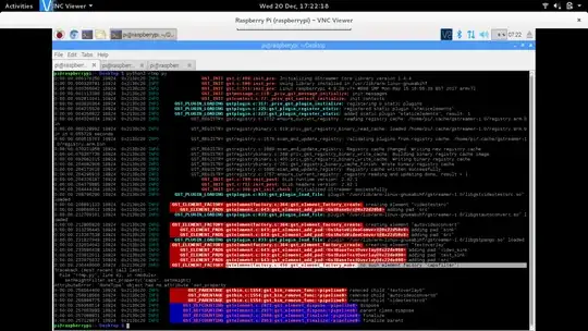

I have tried uninstalling and reinstalling GStreamer on the Raspberry Pi 3 and I keep finding that I have missing elements.
This is the Pi on Log Level 4 (GStreamer): Raspberry Pi Log

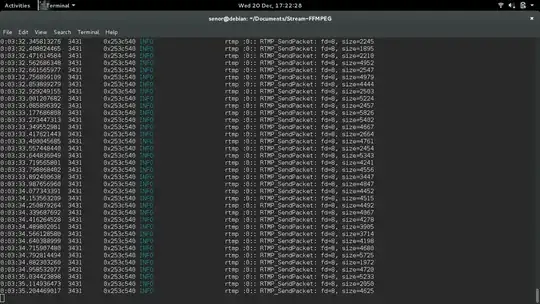

This is my laptop, running Debian with the same exact Python script: Laptop Log
The script was executed as "python3 rtmp.py". Both are log level 4.
I had uninstalled and reinstalled these packages "python3-gst-1.0 libgstreamer-plugins-base1.0-0 libgstreamer-plugins-base1.0-dev libgstreamer1.0-0 libgstreamer1.0-dev gstreamer1.0-plugins-good gstreamer1.0-plugins-bad gstreamer1.0-plugins-base gstreamer1.0-tools gstreamer1.0-alsa gstreamer1.0-omx".
