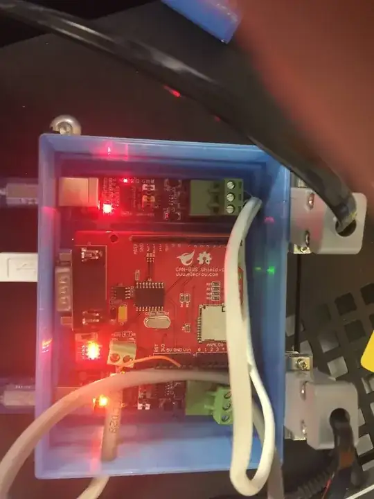

I am reading values from a Battery Management System using two, serial USB-RS485 adaptors (ftdi). I am doing this over MODBUS using the minimal modbus library and python:
# Bank A
# port name, slave address (in decimal)
instrument_A = minimalmodbus.Instrument('/dev/ttyUSB0', 1)
# Bank B
instrument_B = minimalmodbus.Instrument('/dev/ttyUSB1', 1)
# Port on which to send via serial to CAN Shield Arduino
port = '/dev/ttyACM0'
# Initialize CAN Shield Arduino Serial Line
ard = serial.Serial(port, 115200, timeout=5)
// Read something from BMS
socA = instrument_A.read_register(40008)
See picture below
I am reading these values repeatedly, and then sending them over another serial/UART to an arduino which is then controlling some things..
Now this all works absolutely fine on my laptop, which runs ubuntu - but it only works on the Pi for a few reads, after which it fails.
Is the raspberry pi not capable of doing this many serial concurrent processes at once?
