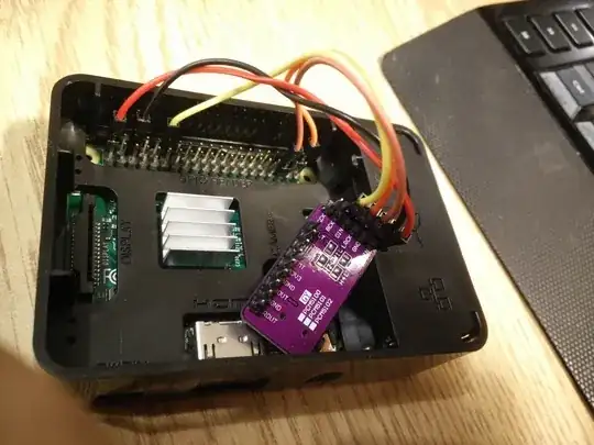

I purchased a PCM5102 for my PiZeroW, but having problems finding
  1. complete driver software information
  2. voltage information
  3. wiring information.
I chose this particular unit because they seemed very popular on Ebay when talking about adding I2S sound to Raspberry Pi.
With so many on sale, I guessed instructions would be easy to find.
enter image description here What is the Device Driver / Device Setup
I have been watching the Adafruit setup of a different I2S unit. Looking for hints. https://www.youtube.com/watch?v=kkaYTIC0RoQ
aplay -l
This should show available sound cards. But I don't get any. I suspect I have the wrong boot config. I do have I2S enabled in the /boot/config.txt, also set the
dtoverlay=hifiberry-dac
I have setup /etc/asound.conf as well.
What is the Vcc Voltage for this card? 3.3v or 5v?
The raw chip looks to be 3.3v, according to the datasheet, but there are many surface mount resistors on the card, any could be used to pull down a Vcc of 5volts to 3.3v. http://www.ti.com/general/docs/datasheetdiagram.tsp?genericPartNumber=PCM5102&diagramId=SLAS764B
I've gone conservative for now, picking 3.3v. Trying to keep the magic smoke within the unit:)
Wiring the PCM5102 to the PiW
Other than Vcc, the other wiring I deduced from here.
http://masterandrey.com/posts/en/dac_raspberry_pi_pcm5102/ http://www.denshi.club/pc/audio/raspberry-pi-2i2s-dac.html
Is the MCK (SCK) line to be connected, or left unconnected as suggested by www.denshi.club ?
Symptoms
No sound when using headphones plugged into the 3.5mm jack.
The led on the card comes on.
Sorry, I don't have a scope, so I'm not able to test the I2S lines.
aplay -l
Not seeing any cards listed.

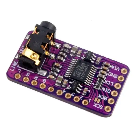

On these purple PCBs there are 5 sets of bridging pads.
On the front (component side) there is one pair of pads which may be bridged to tie the SCK (system clock) low. This will force the PCM510x to generate the system clock using its internal PLL. You may bridge these pads to remove the need for an external SCK or connect the SCK pin to ground (0V). The Raspberry Pi does not supply a system clock so this will be required to connect to the Raspberry Pi.
On the back (non-component side) there are 4 sets of 3 pads for the 4 functions:
  1. FLT - Filter select : Normal latency (Low) / Low latency (High)
  2. DEMP - De-emphasis control for 44.1kHz sampling rate: Off (Low) / On (High)
  3. XSMT - Soft mute control(1): Soft mute (Low) / soft un-mute (High)
  4. FMT - Audio format selection : I2S (Low) / Left justified (High)
The centre pad is connected to the corresponding pin. Each of these function pads may be bridged with solder either high or low (or the pins connected to +3.3V / 0V). (My board is supplied with 1, 2 & 4 bridged low and 3 bridged high, i.e. normal latency filter, 44.1kHz de-emphasis disabled, soft-mute not asserted, I2S audio format.)
The normal filter is an FIR with good response, delaying the signal by approx. 500us (at 44.1 kHz) which should be fine. The fast filter is an IIR with slightly poorer response and delays the signal approx. 80us. Very few (if any) audio sources have pre-emphasis applied so DEMP should be low. The XSMT pin would allow muting of the output via a GPI (if the solder bridge was removed). Raspberry Pi supports I2S bitstream so FMT should be low.
*Do not connect pins to a supply rail if the solder bridges are applied.
The VIN pin goes to a pair of voltage regulators, one of which provides the 3.3V required by the PCM510x. This also connects to the A3V3 pin. The regulator is low drop so VIN may be fed from 3.3V or 5V.
The input pins SCK, BCK, DIN & LCK are fed through a resistor pack which should allow 5V signals to be connected to the 3.3V PCM510x chip, i.e. the board is 3.3V but 5V tolerant.
*Note: LCK pin is actually LRCK (left right clock).
The 'L' & 'R' pins are directly connected to the 3.5mm jack. Simultaneous connection to both should be avoided. The 2 'G' pins are connected to ground and are provided for convenience of wiring audio output jacks.
This is a very well designed PCB. It is a shame that this description is not provided elsewhere.

9
I was able to make this unit work with my Raspberry Pi 3 using volumio and osmc without the need of any software tweaking. I must say that it sounds very good on both distributions.
While using both the distributions, I selected the HifiBerry DAC profile from system settings.
Note that my unit came with the jumpers for the extended headers already shorted. In the picture below, you can see the little jumpers.
For powering up the board:
There's a 3.3V regulator already on the audio board and you can leave it unconnected. I ended up connecting the 5V rail from the rpi to the VIN of the DAC and it works just fine. The blue LED on the DAC should light up when it's powered up correctly.
Wiring Pinout:
DAC BOARD   > Raspberry Pi 3 Model B connector J8
SCK         > Not wired (Internally generated)
BCK         > PIN 12    (GPIO18)
DIN         > PIN 40    (GPIO21)
LRCK        > PIN 35    (GPIO19)
GND         > PIN 6     (GND) Ground
VIN         > PIN 2     (5V)
FLT             > Not wired
DEMP            > Not wired
XSMT            > Not wired
FMT             > Not wired
A3V3            > Not wired
AGND            > Not wired (Same as headphone out)
ROUT            > Not wired (Same as headphone out)
AGNDL           > Not wired (Same as headphone out)
LROUT           > Not wired (Same as headphone out)

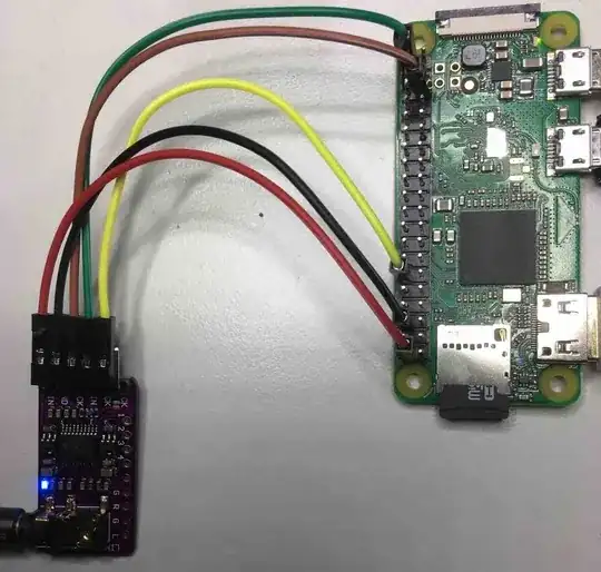

DAC BOARD > Raspberry Pi ZeroW connector J8
 GND         > PIN 6     (GND)
 VIN         > PIN 2     (5V)
Pinouts - Credit Kamran Sethi

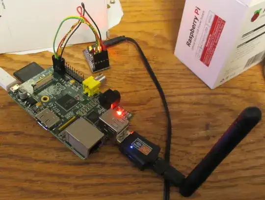

This post doesn't add much fundamentally new information, but it does (1) give a step-by-step visual guide, and (2) document the process for an older Pi 1 B with the "P5" header.

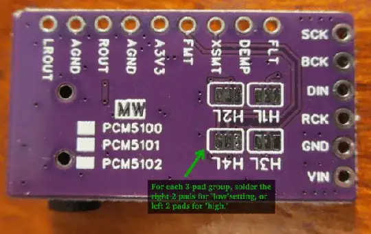

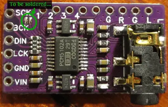

Here's how my DAC arrived — notice none of the pads are soldered, unlike most of the pictures you see online.
DAC top, original
DAC bottom, original
As the other answers note, the 3-pad groupings are used to select functionality for the DAC.
Using the labeling on my board, we want:
  • H1L: FLT — "low" for normal latency filter
  • H2L: DEMP — "low" to disable
  • H3L: XSMT — "high" to disable
  • H4L: FMT — "low" for I2S
A later picture will show these.
Aside: For soldering the pads, I found it very useful to "paint" the desired 2 pads with flux. Then, the solder flows nicely onto them and avoids the other unwanted pad. They are pretty small, so it's a little fussy to get right.

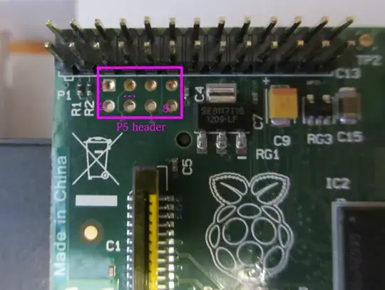

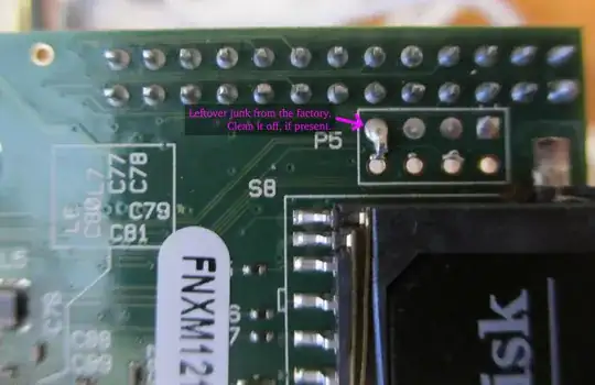

Next, here is my Raspberry Pi board, showing the P5 header that we'll use.
Pi top, original
The P5 header is fairly well-documented here: https://www.raspberrypi-spy.co.uk/2012/09/raspberry-pi-p5-header/ There is some more good info in the original announcement from 2012: https://web.archive.org/web/20121021133116/http://www.raspberrypi.org/archives/1929
In particular, they say:
This carries the four GPIO signals [BCM2835/GPIO28 – BCM2835/GPIO31] named GPIO7 – GPIO10 respectively, along with +5V0, +3V3 and two 0V. Currently this connector is not populated.

Note: we do not use the "SCK" pin on the DAC. As noted in other answers, we solder the pad just next to it, which causes the board to use an internal timer. This corresponds to the optional "master clock" mentioned on Wikipedia — it is not part of the I2S standard. It is sometimes written MCK.

Note: my Pi had some crud on bottom of the P5 header, which I cleaned off before proceeding. I think it was safe as-is, since the shorted-out part was just the two Ground pins, but just being tidy:
Pi bottom, original, with crud

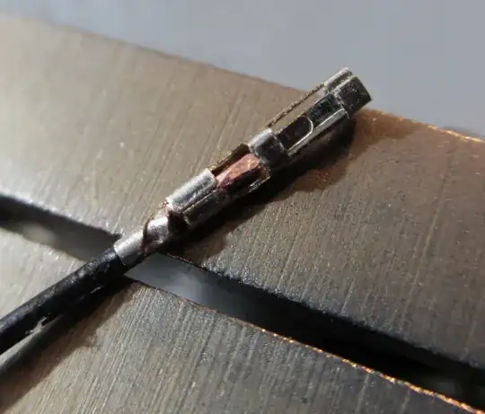

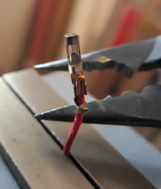

I used some jewelery pliars to do the crimping of the wire terminals — I don't have the proper tool for that. They worked okay.
Work in progress:
pliars
A decent terminal:
wire terminal

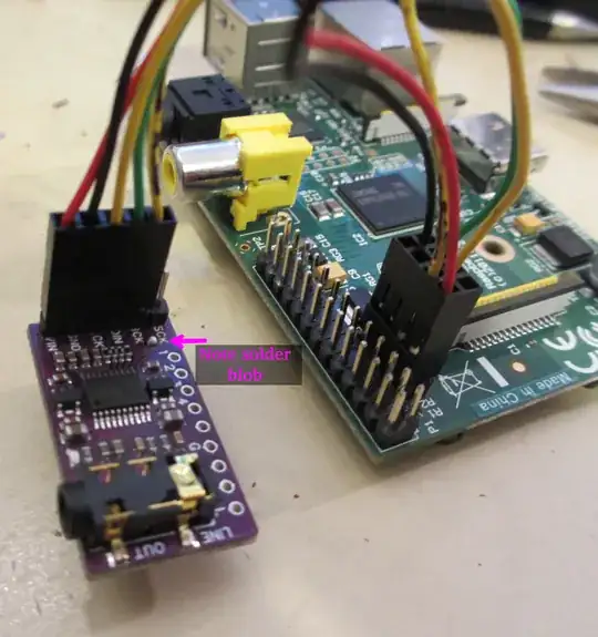

Here it is all hooked up:
wiring, connected
Note the SCK solder blob.
For reference, these are the wire colors corresponding to the pins:
Color DAC pin Pi Pin Meaning
Red VIN 5V +5V power
Black GND Ground 0V Ground
Yellow LCK PCM_FS word select/frame sync clock
Green DIN PCM_DOUT serial data
Yellow+Black BCK PCM_CLK bit clock
And plugged in with power, WiFi, etc (the DAC has a solid red LED when properly powered):
wide shot, all powered on

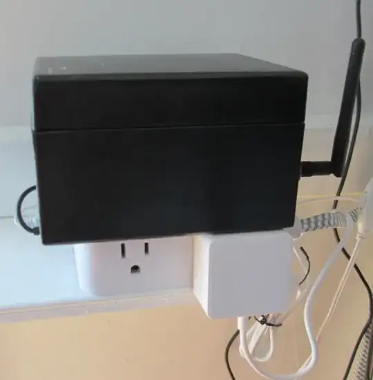

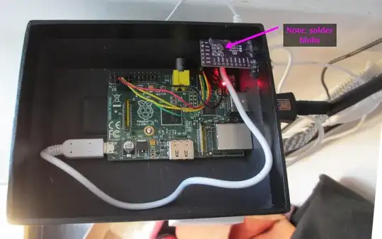

And then put in a box:
mounted in a box
Note the solder blobs for H1L–H4L. Also: I like hot glue.
And finally put to use!
final installation, all closed up
A little janky, but it works (:
