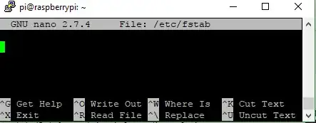

I've found that raspi-config gives an error that there's nothing mounted, tried mounting with "mount /dev/mmcblk0p1 /boot", and then atleast I can access raspi-config but can still not edit anything with Nano. Looking through Google I also noticed that my /etc/fstab file is completely empty, and should be filled with something else. enter image description here

Since it seems that your /etc/fstab is missing, you may want to fill it in with the necessary information. You'll need to manually mount the root and boot partitions first:
sudo mount -o remount,rw /dev/mmcblk0p1 /boot
sudo mount -o remount,rw /dev/mmcblk0p2 /
And then create a new /etc/fstab
sudo echo -e "proc            /proc           proc    defaults          0       0\n/dev/mmcblk0p1  /boot           vfat    defaults          0       2\n/dev/mmcblk0p2  /               ext4    defaults,noatime  0       1" > /etc/fstab
And the to verify that the above command worked:
$cat /etc/fstab
And then change the root partition in your cmdline.txt to /dev/mmcblk0p2 You can do this on your Windows machine, just like you did to add the IP.
dwc_otg.lpm_enable=0 console=serial0,115200 console=tty1 root=/dev/mmcblk0p2 rootfstype=ext4 elevator=deadline fsck.repair=yes rootwait quiet splash plymouth.ignore-serial-consoles
