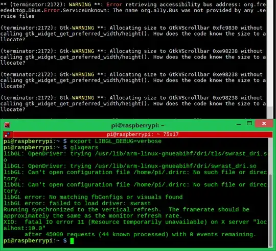

I'm having issues when working on my RaspberryPi via SSH on MobaXterm that I can't resolve by myself. Appearantly there are some driver issues when using SSH and running programs that require the openGL library. I've tested the problem with glxgears to verify. On SSH startup I run terminator to have more than one terminal, which works fine except that those Gtk-Warnings flood my original terminal whenever I do something in terminator, eventually breaking my memory at some point and crashing. Here's a screenshot of the output:
This is what I get

The best way to launch X applications before conecct with a ssh -X is adding nohup to avoid this errors:
 nohup glxgears &
And you have the application running, the errors dumped in a file called "nohup" and the console operating because you launched the application in background using the "&"
